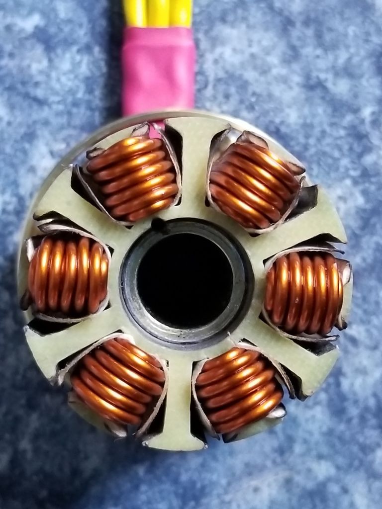

Hello,
I have wound this motor for a 3d heli pilot. It is a 1.5mm single layer, and will be terminated as a parallel wye, essentially 2 three tooth wye motors in parallel. I wonder as compared to the double layer 5+6 YY it will perform. The dual layer shows a lower winding factor but also a lower 1st harmonic in it's BEMF. So I'm curious which of the 2 would likely be the most efficient? In this case I also wonder if max efficiency is the win all. If I generated a little more heat but made more torque for hard maneuvers in the process would it be better? I have my own ideas but instead of going on those alone I'm curious what others have experienced,their knowledge, and so on. Please share your thoughts.

for true you need a test with the same statorplates and double layer wind. And for true you need the real condition. How are the duration amps and how the peek amps. For heli use i think with this shape of plates your singellayer wind will be better . To comare you need to wind the double layer with the same kv ,so maybee one turn moore on each statortooth and possible lower resistance with the single layer motor (one or two urn less for the wind) . With the original statorshape it is no quest.
Very clean and profesionel wind .
Happy Amps Christian

Thank you,
Awfully foolish of me to have not utilized the extra space allotted by winding it in a single layer and used 1.6mm instead. I do have an identical stator so I can wind it in a dl for the same kv and let the pilot test it for comparison and send me back his logs. I guess he will need to do the same 3d maneuvers on both motors with fully charged batteries. The next thing I think of with this single layer is good heat dissipation and thermal conductivity between the overlapping coils, so I searched for an appropriate electrical resin. One with low viscosity, to get in between , thermal conductivity, and heat class. Scotchcast 265 1 part electrical resin from 3m seems to be very appropriate in all aspects. Very expensive at 1200.00 usd for 55 pounds (24.9 kg). It is a powder that can be mixed with acetone. U dip the wound stator or preformed coils in it then let the acetone flash away. Then it will cure in an oven for 20 min at 350*F. This is a great material for pre forming self supported coils also. It is professional grade.

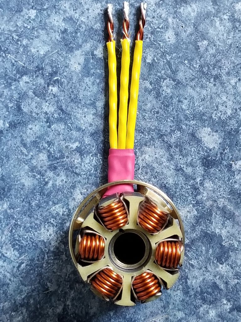

Thanks. Hopefully one day from the modeler Ill hear how it runs in his model since its done and leaving me today. :w It runs good here on the bench. The Kv came out to be 518. Bemf was 3.07 +/- .01 Vrms on all phases @2250 rpm
Spiritus Alcohol....here our equivalent is 190 proof everclear. To buy this in my state you must purchase it at the Alcoholic Beverage Commision. The "ABC" store only open mon thru saturday and always closes a 9p.m. EST. A few shots of this and a model will probably be the furthest thing from ones mind :dumm:
