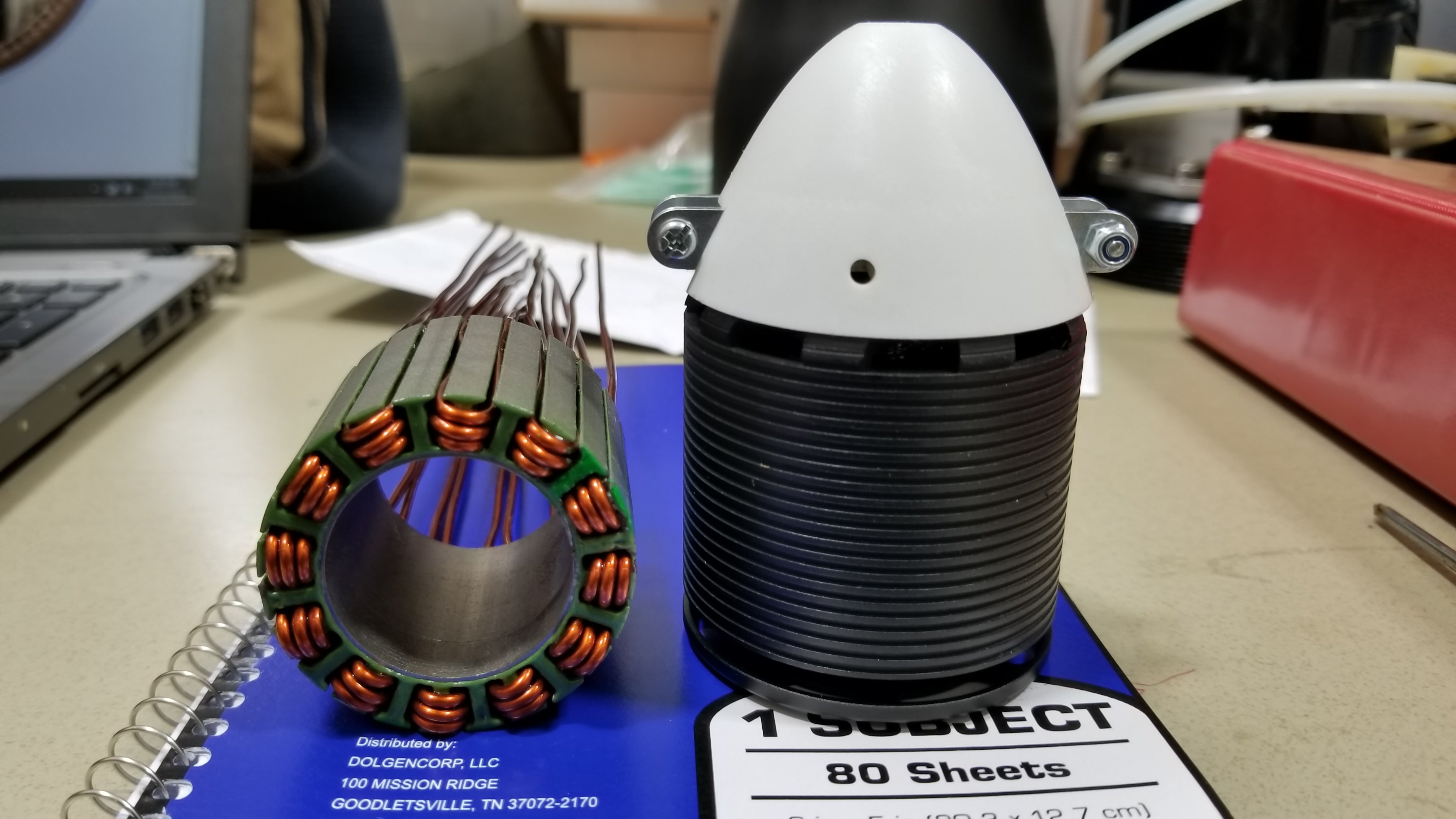

No data needed. Your motors posted are not 1. Do the math. Scorpion-fan. Both have less Kw less than the single layer 24N22P 4635 Neu which is .95766 and in a dual layer it is .94947. Your motor 24N20P is .93301 in a dl and ,.96593 in a single layer. Your scorpion motor in 24N28P is .93301 in a dual layer .96593 in a single layer. The NEU in a dual layer and single is higher than the scorpion DL you show and essentially the same Kw in single layer. Which looks like a copy of Christians old heli plates. Older than 3 years! As you see your photo does not observe the phase distribution of the SPS patent. Nor does it have parallel slots of the Lehner. Why challenge Neu? Steve Neu knows how to design motors as does Lehner. I lose less wind factor between the dual and single layer winds. This is very silly even for you. If you think you have designed a true to patent SPS stator you cant sell it and it would have recorded a pulsating torque verifiable with results. Where is your data. You are here talking.
You need to contact Lehner with your issue. I am not affiliated.
In German....
Du bist verrückt.

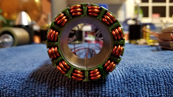

No distractions. I'm certainly not sharing in detail what my future plans are with NEU parts with an enigma like you. Its already better design than scorpion as is as you can see.This "old" design actually comes off the shelf. Does scorpions? The only thing to be concerned with is the motors you posted are not 1 so you are incorrect. I will be trying the motor with a controller that has the highest power density in the word from Advanced Power Drives . 18s 300 amperes. Has pwm dithering , synchronous rectification, and high pwm capable drivers for low inductance machines. 32 BIT and 1,000,000 erpm for fast high pole count outrunner commutation if we want it. :w
I did include for you a photo of an 18 slot stator that will get specially prepared bell from Neu .
Im up to 14 edits now. :ok:

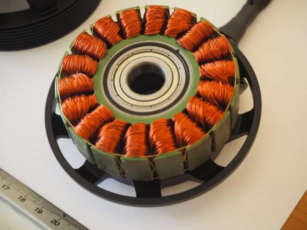

warum schreibst du nicht, dass der neumotor am ende genauso aussieht, wie c.l.s helistator?
komisch, dass die 24N statoren alle 24 Arme haben und ein loch in der mitte - die müssen einfach alle kopiert sein!
man o man....
na, dann warten wir einfach mal ab, ob du diesmal ein komplettes projekt zusammen bringst oder o du es machst wie dein lehrer, der ja auch immer nur unvollendete sachen postet - jedenfalls, seit ich ihn und seine beiträge kenne.
übrigens könntest du die säge ansetzen und in den SPS bewickelten neumotorstator die flusssperren reinsägen - die hat er ja auch noch nicht und damit müsste er ja wesentlich besser sein!

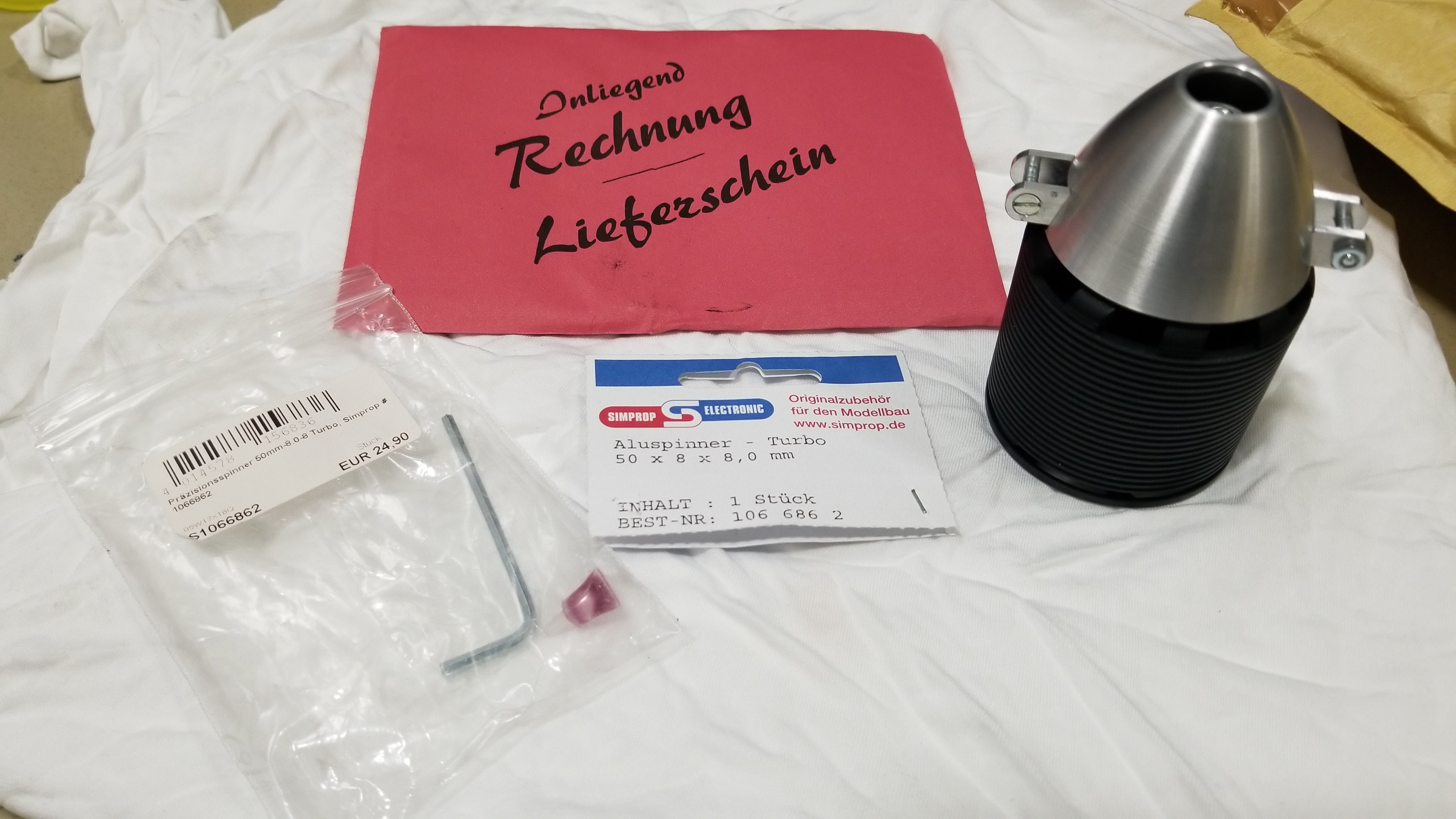

The other spinner system arrived from Germany today.Time for folder props. I will enjoy it and running the 4635 in several different winds with the new controller with the highest power density in the world. No big bulky electrolytic capacitors but high performance MLCC's. Its smaller than a 320 which is 140,980 mm^2 at 112,000 mm^2 . Is the 400 smaller than the 320? It has nearly 4 times the PWM drive capability. 32bit F4 can do 2,000,000 erpm with can bus and logging disabled. :tongue:

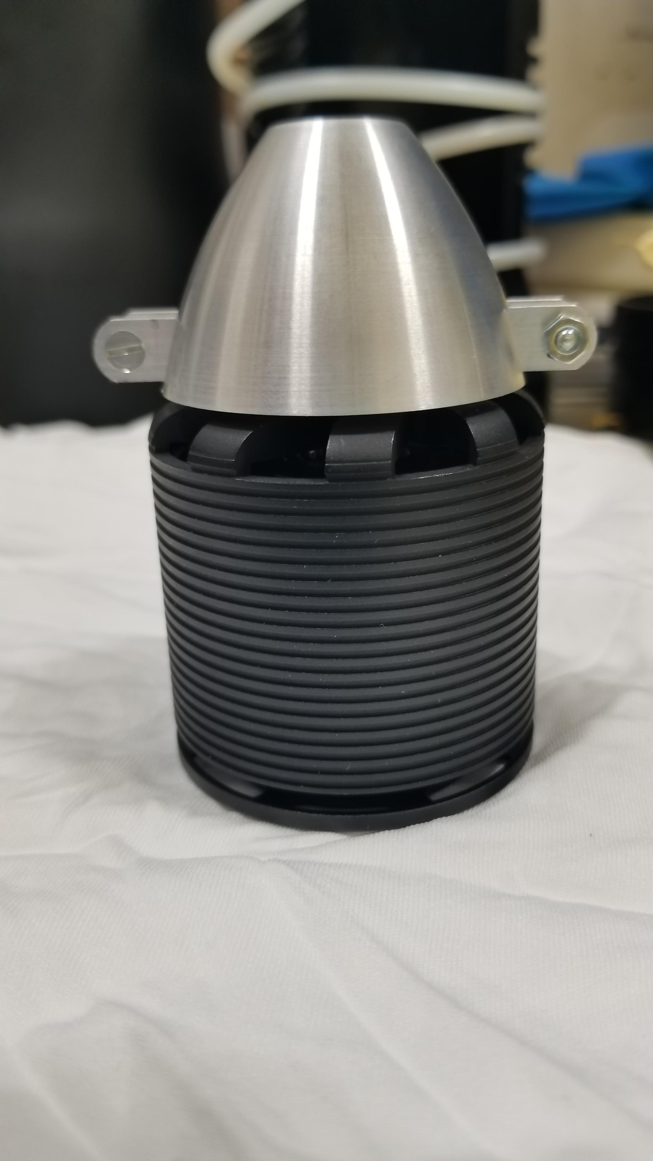

Mittwoch, 31. Oktober 2018, 21:57

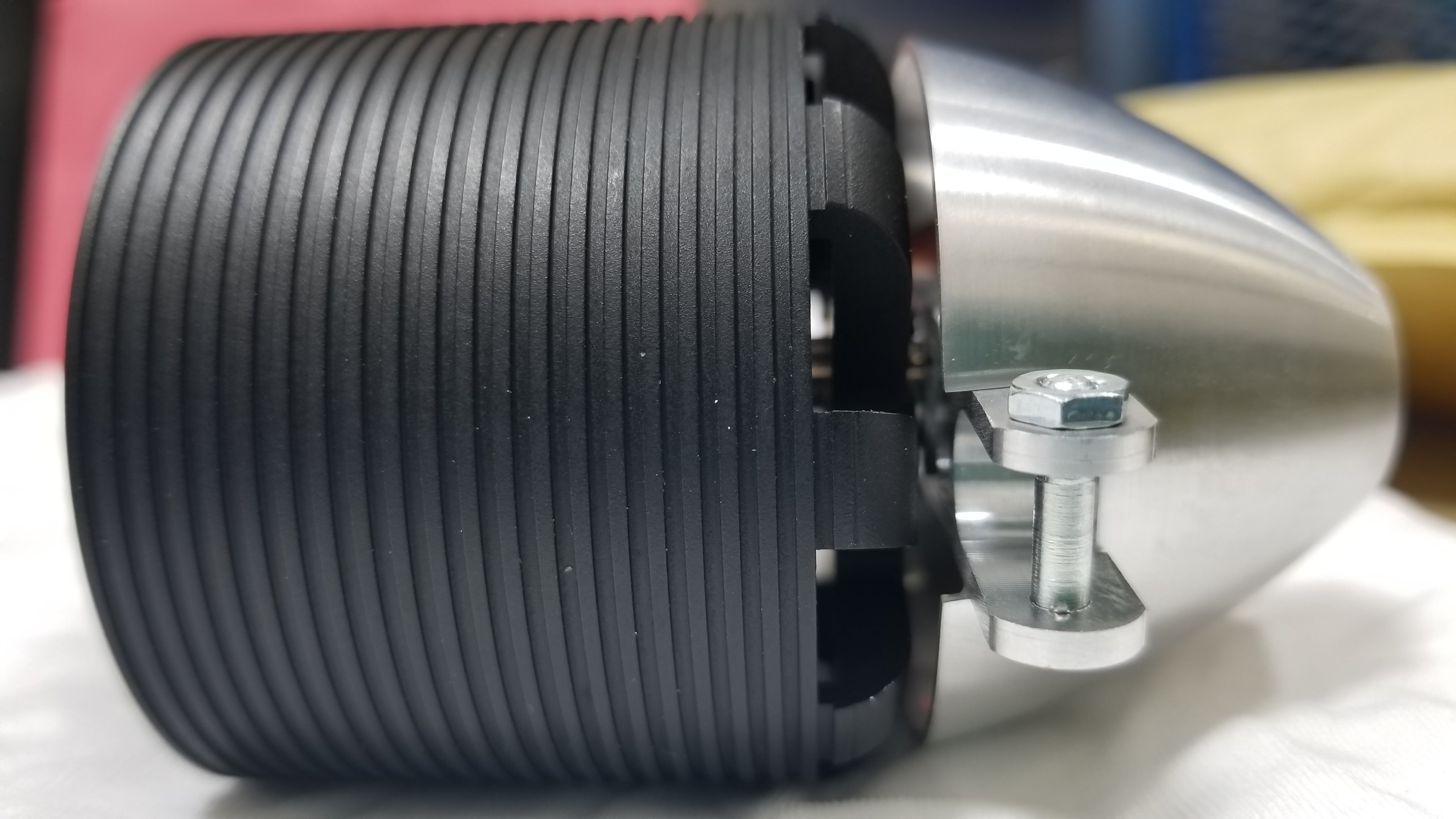

The Reisenauer folding system arrive from Germany yesterday. It fits really nicely. In your opinions. Which spinner does the better job cooling? The wide open Simprop Turbo or the Reisenauer with the internal fins directing air flow?
IEEE member 93895120
My Gallery
AND NO I DID NOT VOTE FOR HIM!
Dieser Beitrag wurde bereits 5 mal editiert, zuletzt von »Cohesive« (31. Oktober 2018, 22:48)
